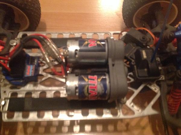

Så dette billede: http://forum.losi.com/showthread.php?t=2410&page=3
